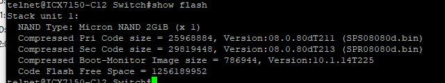

Hello @raymond_jender ,
Thank you for your response.
We suggest upgrading your switch to the latest stable version to avoid this issue in the future. Your Switch is on an older version that is 08080d.
Please follow the below RUCKUS Lennar Knowledge base self-help article which will help you to upgrade the switch to the recommended version
Please observe the speed after upgrading the Switch and if the issue still persists, we would suggest you to please perform factory reset on APs.
Please follow the process explained in the article and let me know if you have any queries in this regard.

Do I run this procedure at: https://docs.commscope.com/bundle/fastiron-08095-upgradeguide/page/GUID-5DD7EE86-6988-4CA7-81D2-22EA...
Please follow the Option-2 (upgrade using CLI)outlined in the RUCKUS Lennar Knowledge base self-help article shared in our previous post/communication.
Please follow the option-2 process explained in the article and let me know if you have any queries in this regard.
