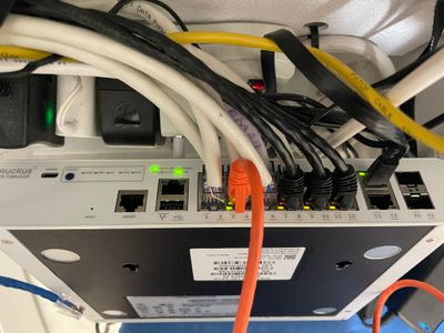

I have the ICX-7150 which is powered on and shows green lights. I have two R510s on two different floors that wont turn on. I took one off the ceiling and connected it to a 12VDC and a different POE and it turns on but when connected to the ethernet cable coming out of the ceiling, it does not work.

From the case description, as per the light status on the Switch and APs, we need to confirm if the PoE is disabled or not.
On your switch while it's plugged into the outlet, please let us know which lights are on. (Please refer to the below picture and share a picture of the same, showing the light status and the FULL Switch panel cable connections to the Switch ports)
