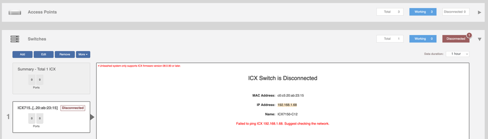

We had a power outage a few days ago and our WiFi has not been working consistently since, especially on our Apple devices. I read through a few articles and I saw that accessing the Unleashed Dashboard was step 1. As shown below, our switch is saying its disconnected.
I saw a similar post to mine where step 2 was to log into the switch using the IP address. I tried posting the IP address (192.168.1.68) into my Firefox browser window, but a login screen didn't pop up. It just kept spinning until it finally timeout out.
I've unplugged and pulled back in the switch multiple times, all lights I can see on the switch are green.
Any idea what I can do to get this fixed?Screenshot 2024-07-01 at 10.03.24 PM.png
