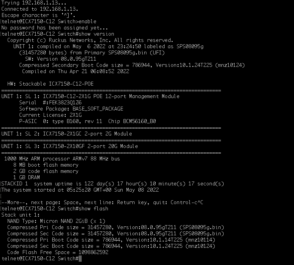

PFB requested details (I have attached screen shot also)Switch infoSwitch info:
telnet@ICX7150-C12 Switch#show version
    UNIT 1: compiled on May  6 2022 at 23:24:50 labeled as SPS08095g
      (31457280 bytes) from Primary SPS08095g.bin (UFI)
        SW: Version 08.0.95gT211
      Compressed Secondary Boot Code size = 786944, Version:10.1.24T225 (mnz10124)
       Compiled on Thu Apr 21 06:08:52 2022
  HW: Stackable ICX7150-C12-POE
      Serial  #:FEK3823Q1Z6
      Software Package: BASE_SOFT_PACKAGE
      Current License: 2X1G
      P-ASIC  0: type B160, rev 11  Chip BCM56160_B0
    8 MB boot flash memory
    2 GB code flash memory
    1 GB DRAM
STACKID 1  system uptime is 122 day(s) 17 hour(s) 10 minute(s) 17 second(s)
The system started at 05:25:20 GMT+00 Sun May 08 2022
--More--, next page: Space, next line: Return key, quit: Control-c^C
telnet@ICX7150-C12 Switch#show flash
Stack unit 1:
  Compressed Pri Code size = 31457280, Version:08.0.95gT211 (SPS08095g.bin)
  Compressed Sec Code size = 31457280, Version:08.0.95gT211 (SPS08095g.bin)
  Compressed Pri Boot Code size = 786944, Version:10.1.14T225 (mnz10114)
  Compressed Sec Boot Code size = 786944, Version:10.1.24T225 (mnz10124)
  Code Flash Free Space = 1098862592
Hello @saurabhk01 ,
From the response you shared, we suggest you upgrade your ALL RUCKUS Access Points to version 200.15.6.12.304 which is recently released.
Please follow the below RUCKUS Lennar Knowledge base self-help article which will help you to upgrade the Ruckus AP to a recommended version
https://community.ruckuswireless.com/t5/RUCKUS-Lennar-Support-Knowledge/Upgrade-process-of-the-RUCKU...

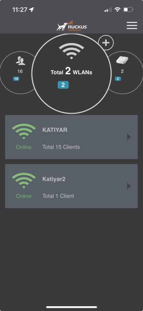

Can this AP upgrade done through unleashed APP as I can not access dashboard on my computer, it never open?
Could you please also let me know why APP do not show switch?
Unleashed APP PhotoUnleashed APP Photo

Based on your description, it appears that you are experiencing difficulty logging into the RUCKUS Unleashed application and web browser.
Apologies, Unleashed system cannot be upgraded using the Mobile Application.
