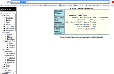

None of those combinations worked.  I can go to 10.0.0.98 (see attachment in previous messsage) and login but those credentials dont works for this web page either.

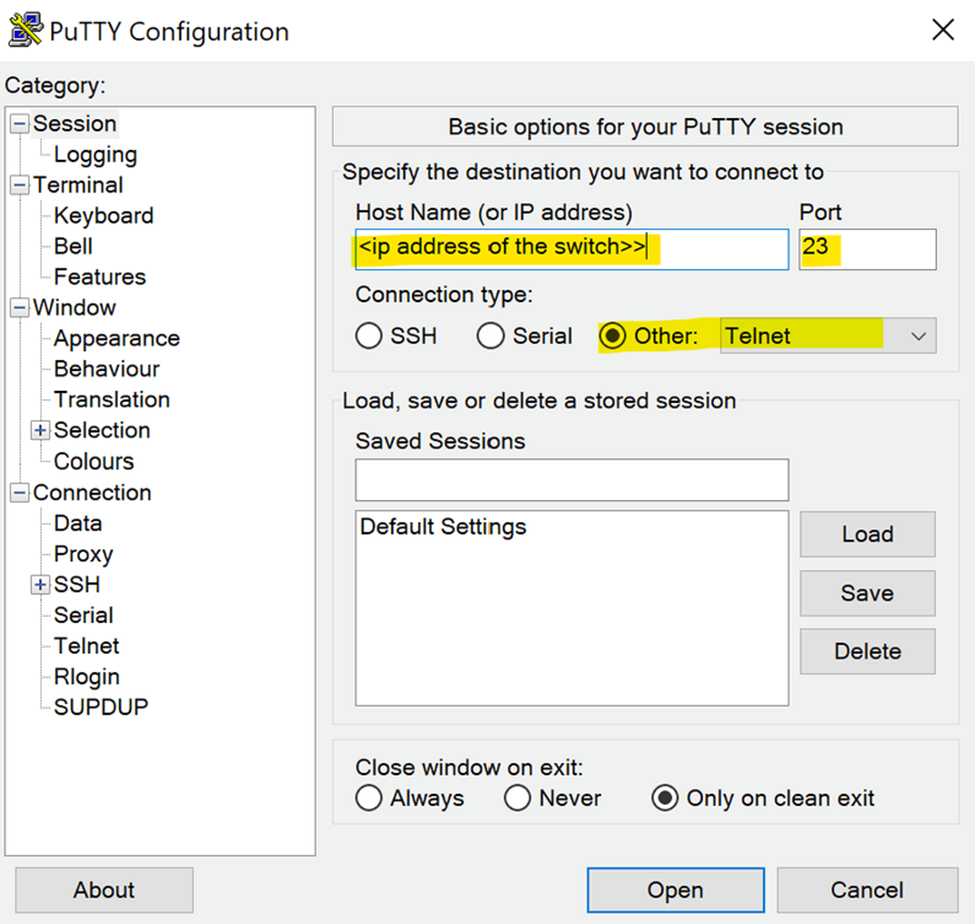

As you are aware of the Switch IP address, I would request you to please access the CLI of the Switch using the Telnet option.
We do not need any login credentials to access CLI using the Telnet option. If Telnet is enabled on the Switch it can be accessed directly using an IP Address of the Switch.

I can login http://10.0.0.246/ now so I do not understand why the software is not working.
