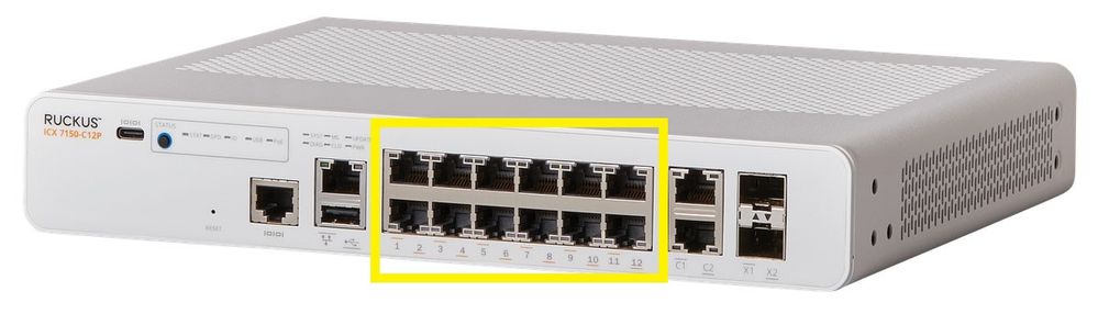

If I have to wire directly to the switch, which port(s) do I wire it to?

You can be wired or wireless from your local router ISP or Connected directly into the Ruckus witch to try to find the IP address from the Access Points
