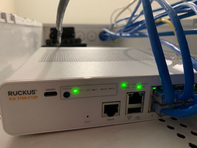

1. Was there any power outage before you started facing this issue?
2. On your switch while it's plugged into the outlet, do you see any lights on? (Amber or green) Please let us know which lights are on. (Please refer to the below picture and share a picture of the same)
3. May I know how many Access Points are connected to the Switch? Could you please let me know the light status on the Access Points? Any of these lights are on (Please refer to the below picture and share a picture of the same)
Please help us with pictures of your ICX-7150-C12P Switch showing the status of the lights. Also, light the status of Access Points.

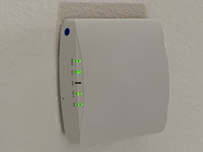

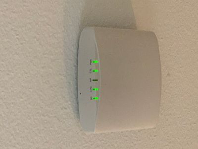

Hi Imran,
Thanks for your response. There wasn't any power outage prior to this issue, but we have had spotty connection through ruckus for a few weeks now (connection is just fine through the att router). I'm attaching pictures of the switch lights and of our two access points. On the access points it looks like all lights are on except the AIR which, but maybe it's just dim.
