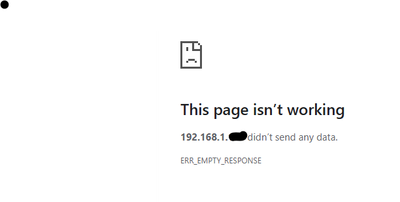

So I put in the IP address and it took me to unleashed login so I put in the admin and pwd and it takes me to this:

Hi @Jrwilliams23
Please try to factory reset the Access Points and configure a new Wi-Fi/SSID. Please refer to the factory reset guide shared in my previous post.
Let me know if you are stuck at any point during the factory reset process.
Thank you for the patience and understanding.
