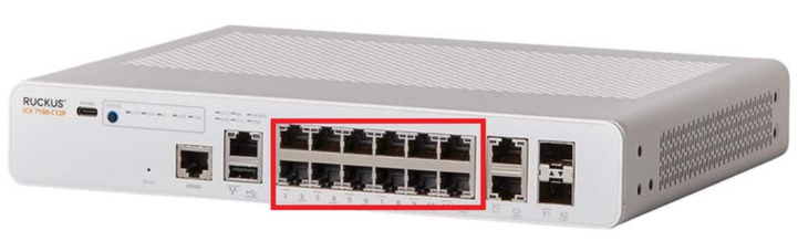

Could you please try to replace an ethernet cable of your AP and check on the different cable on different ports on the Switch ports in those 12 ports as shown in the below picture?
