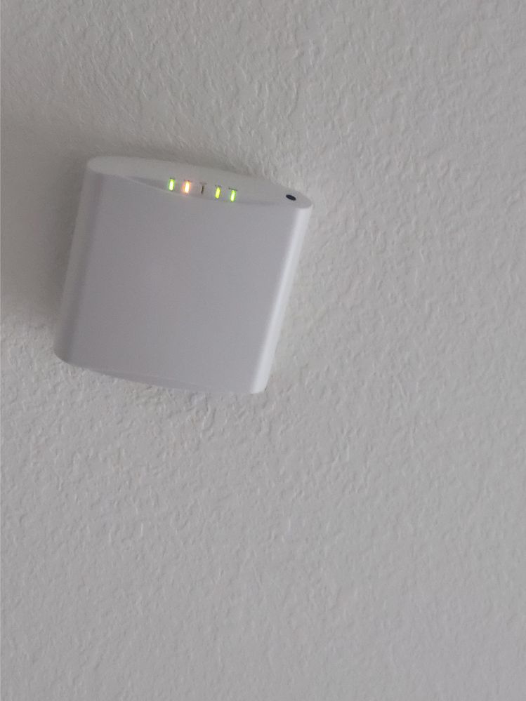

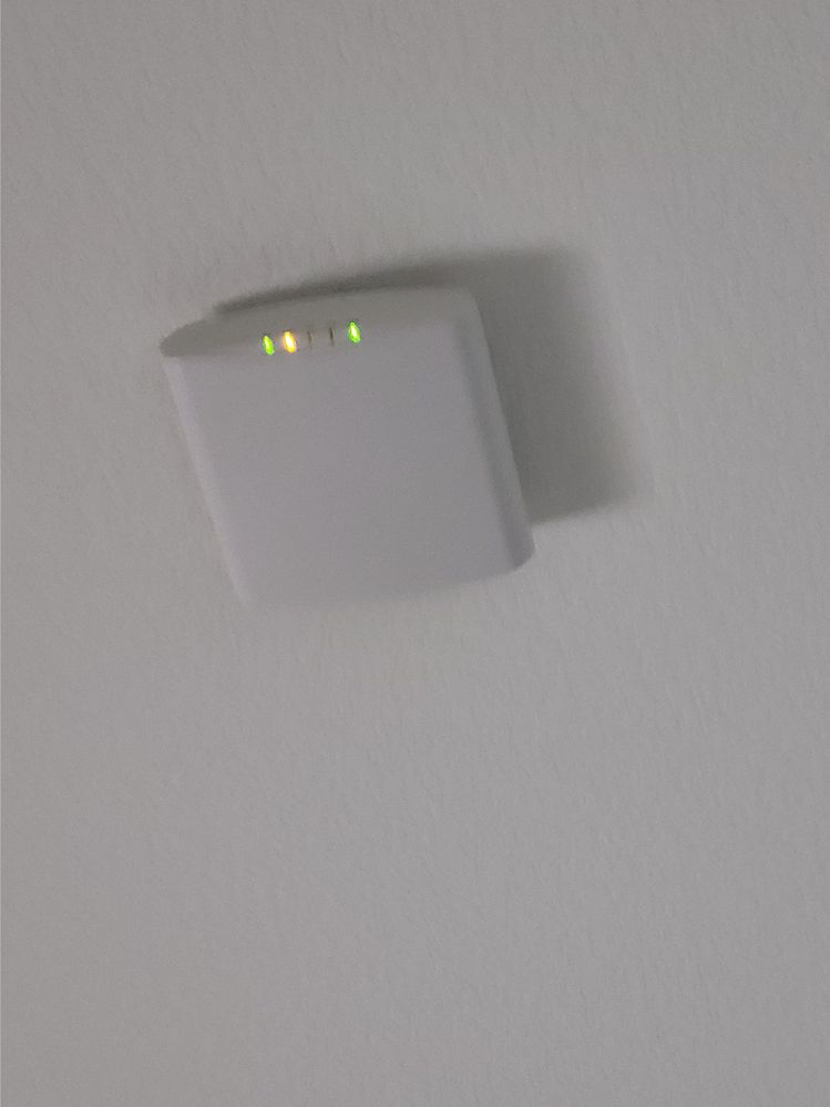

10-05-2023 04:25 PM
I was able to connect - thank you once again
but I still see yellow light in both the ruckus boxed on the ceiling. what could be the reason?
PFA screenshot of both.
10-06-2023 06:30 AM
Hi @nitech
To solve this issue, we have to check whether is there any software issues. For that here I attach few guides to follow the steps.
This guide show you how to run an IP scanner in order to find the IP address if your Access Points ( Ruckus unleashed ) in order to access via IP via the URL
Once you find the IP address of the AP please enter the below URL in the web browser unleashed.ruckuswireless.com or enter the IP address of the master AP.
Ruckus unleashed upgrade
https://community.ruckuswireless.com/t5/RUCKUS-Support-for-Lennar-Homes/Ruckus-unleashed-upgrade/td-...
Also please check whether the access points are upgraded to the same version or not.
