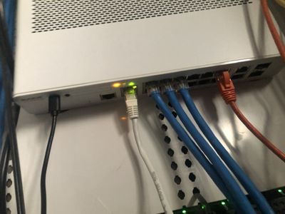

09-05-2023 10:24 AM
Hi @liljazz2007
As the pictures you shared are not so clear, please refer to the below picture and share a picture of the same, showing the light status and the FULL Switch panel cable connections to the Switch ports.

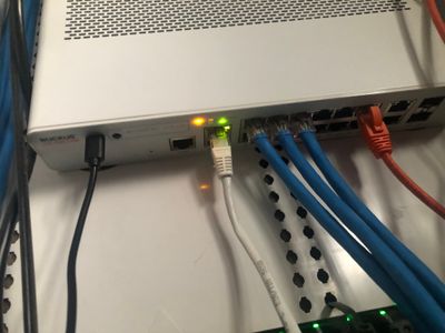

09-05-2023 04:07 PM
Here are very clear photos of what you asked for.
09-05-2023 05:00 PM
Hi @liljazz2007
Thank you for the response and sharing the requested information.
I believe there is some issue with your Laptop COM drivers, or they may require a update.
Have you tried to reset the Switch by using a paper clip?
Please try to reset the Switch as described below:
IF RESET IS NOT WORKING, PLEASE TRY TO RESET YOUR SWITCH MULTIPLE TIMES (Like 10-15 times) AS DESCRIBED ABOVE.
09-05-2023 05:39 PM
I have tried what you presented over 50 times at this point. I have to do those steps every time the switch loses power during a power outage. Those steps usually work but this time it isn’t working, there is something wrong with the switch. I’ve tried other computers and I get the same issue. All of my drivers are updated on all computers. The switch needs to be replaced. The ruckus tech I spoke to in 2021 said he updated the switch’s software/firmware so I wouldn’t have this problem but I’ve had it for over a year every time the power goes out. The same goes for others in my neighborhood. They all said they got bad boxes, which I believe I have. This switch box has a lifetime warranty and you all need to replace it.
