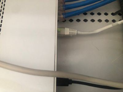

Hi @liljazz2007
Hope you are doing well!!!
As per the case description, I understand that you are trying the software recovery process for the RUCKUS ICX-7150-C12P Switch, which is stuck in boot mode and unable to access it via Putty.
Could you please share a Picture showing the software recovery cable connection between the Switch and the Laptop/PC?

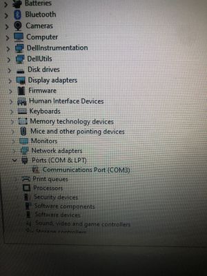

And please help us with a screenshot of the Device Manager showing the COM ports.

09-05-2023 08:53 AM
09-05-2023 08:55 AM
