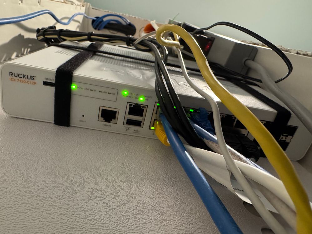

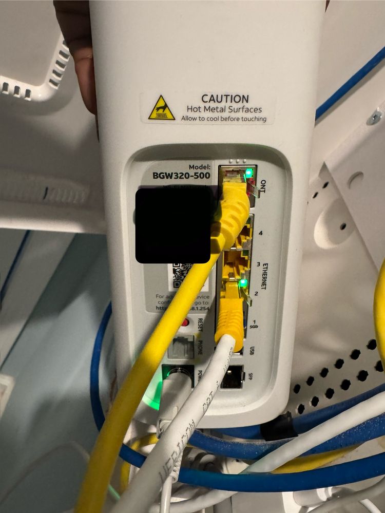

08-28-2025 12:27 PM - edited 08-28-2025 12:32 PM
Hi Pinky,
Please refer attached screenshots of requested photos.
