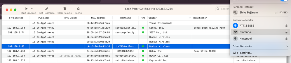

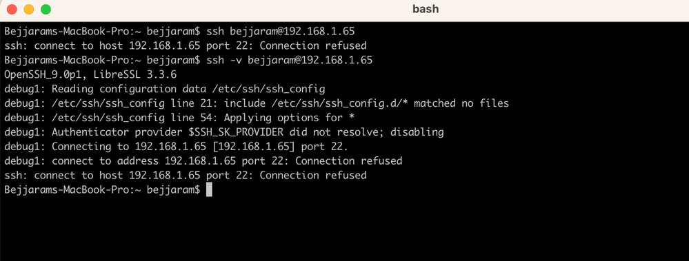

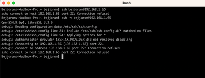

I had to connected to my AT&T network to get the IP address of when i connected to switch ICX-7150-C12P as when i connected ruckus configured network doesn't show the switch. Please refer attached scrrenshots. Afte i connected to AT&T network and get the IP address then do ssh it doesn't connect and connection refused. Please advise what should do here?

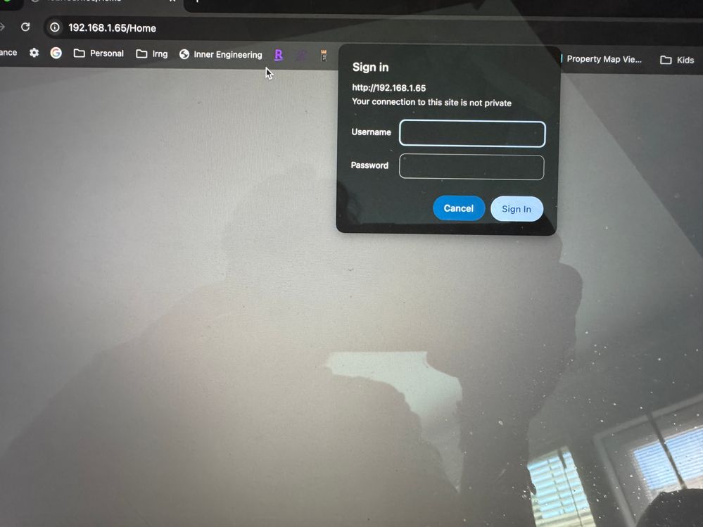

I am able to access GUI of the switch using IP add  when connecIMG_2615.JPGted to AT&T network though not able to login with any credentials that we set on the config page.  Please see attached screenshot.
