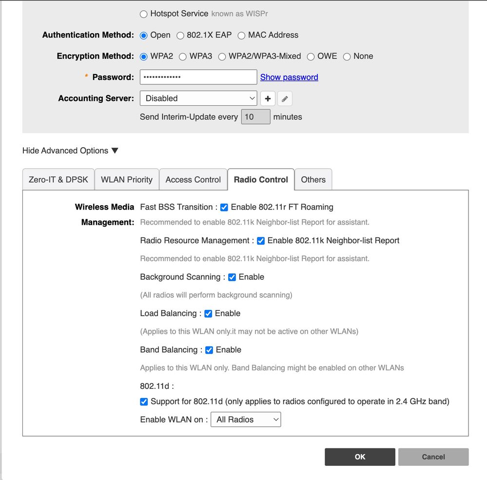

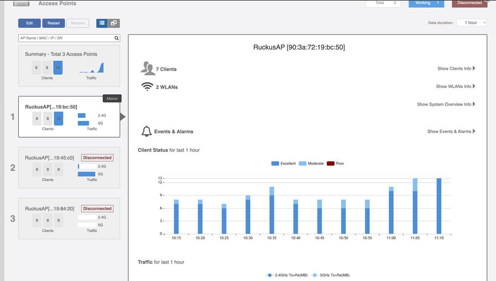

I have just returned from vacation. I have made suggested changes and please see attached the screen shots. I observed that member APs are disconnectedUnleashed_2.jpgUnleashed_configs_1.jpg and master internet speed becomes slow. Could you please advise ?
