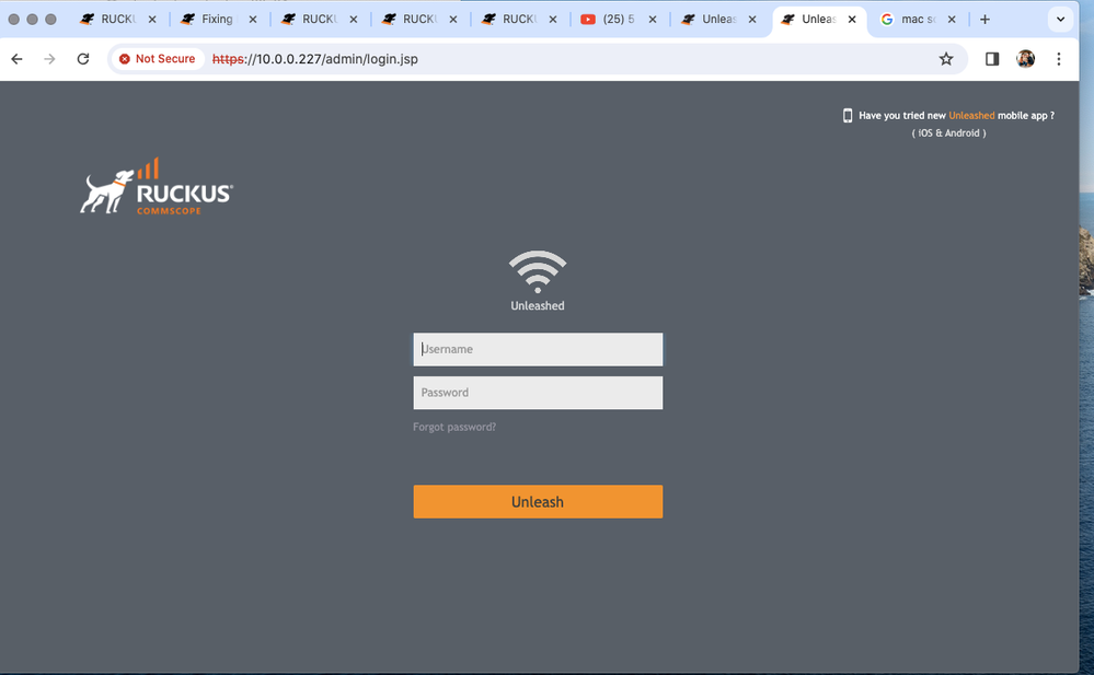

I believe I have encountered SPR issue (for the second time) due to recent power outage. I am attempting to follow instructions listed here, however, when inputting my IP address into my web browser my interface does not match that of the instructions so I am at a standstill as I'm unable to find the proper screens to make a change and correct the routing issue. See below what I receive upon inputting my IP address - closely resembles the Ruckus mobile app.

Hello @adambach89 ,
Hope you are doing well ,
The screen you're seeing is for the RUCKUS Unleashed Wireless Access Point. Could you please attempt to log in on that page using the same credentials you use for the mobile app? If you're unsure of the username and password, here is a list of default credentials for your reference
Once you've accessed the interface, you should find a tab labeled 'Switches.' By clicking on your specific switch within this tab, you'll likely need to determine its IP address.
Here is link for reference :
Also, what you can do is restart your ISP's modem/router and run an IP scan.
You can try 1 by 1 IP address that are listed and check using the URL web browser.

Hi @adambach89
As per the case description, I understand that your RUCKUS Switch is stuck on boot mode after a power outage.
The dashboard you are seeing on the web browser is of Unleashed and not of the ICX-7150-C12P Switch.
Please check the other IP Addresses from the IP scan results, by the name of Ruckus Wireless or Brocade Communications to confirm the IP address of the Switch and access the CLI.
Please refer to the below RUCKUS Lennar Knowledge Base guide to troubleshoot the Routing code issue.

I see only two IP addresses in my scan. one does not work in the web browser URL and the other directs me to the very same screenshot I shared in my original post. See below my IP address from the unleashed app as well as it matches the IP I'm using for the URL. There are no other IP addresses related to Ruckus that show in my scan.

Hello @adambach89
That's the internet Tab could you please click the "Switches tab".
Could you try to reboot the ICX-7150-C12P switch or your modem/router then try again the scan.
Made sure cables are connected correctly.
