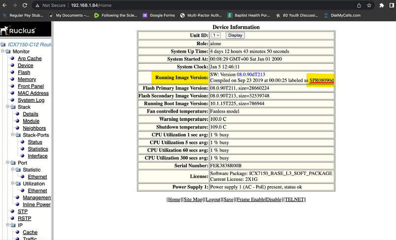

3. If you can log into the Switch on the web browser, please check the details highlighted in FIGURE 2.
FIGURE 2 Device Information with the SPR code as highlighted, to confirm it’s a Routing Code (SPR) issue
If you have ‘Running Image Version’ as SPR highlighted in FIGURE 2 meaning Switch is booted on the Routing code partition (SPR- Indicates the Routing code (SPR) issue AND SPS – Indicates NO Routing Code issue)

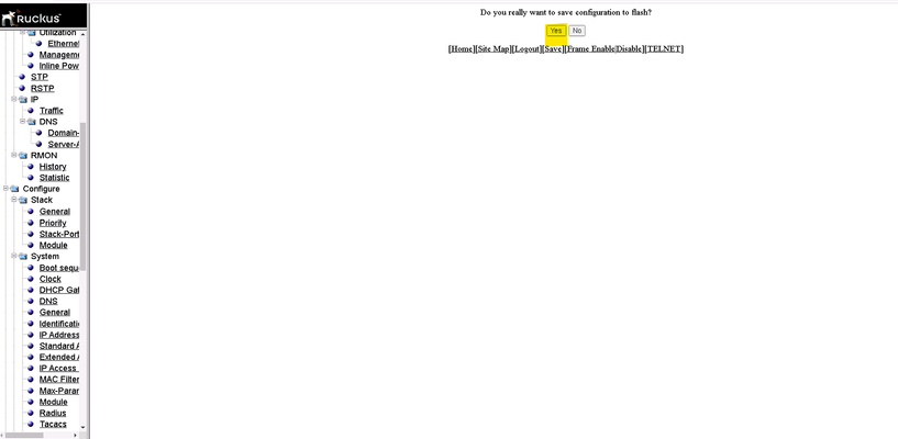

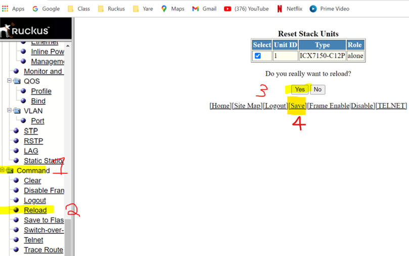

Here is the guide link and the process to fix using the Switch Web Interface/GUI, if you have a Routing Code issue.
FIGURE 3 Process
FIGURE 4 Process
FIGURE 5 Process
Once the RUCKUS ICX-7150-C12P switch reboots/reloads and comes online, it should fix the issue. We can confirm by checking the version and other details as we saw in the FIGURES initially in this post.
