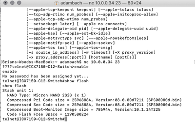

So I was able to get in via CLI and it appears perhaps this isn't a SPR issue after all. See below screenshot as both list SPS rather than SPR. Does everything look normal here? I'm still having issues where my signal/WAPs are rebooting sporadically.

Hi @adambach89
As your Switch is on an older 08080d non-UFI version, we suggest you upgrade the Switch to a recommended stable version.
Please refer to the below RUCKUS Lennar Knowledge base self-help guide for the upgrade process.
Please let me know if you need help at any point during the process.

Hello @adambach89
Don't forget to reload the unit in order to initiate the correct firmware version. Execute the following command: 'reload' and then press 'y' to confirm.
