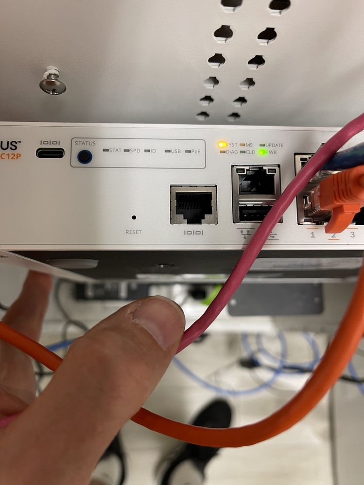

Way earlier today there was a power surge. The power wasn't even out for more than two seconds. The power came on and now I am having issues with my Ruckus ICX7150-C12P and Unleashed R510 Access Point. My internet provider is AT&T and the internet is and has been active and working from the few seconds after the power surge.

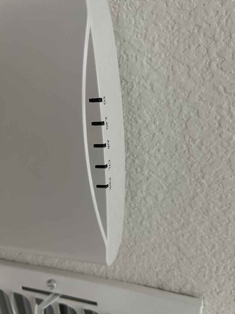

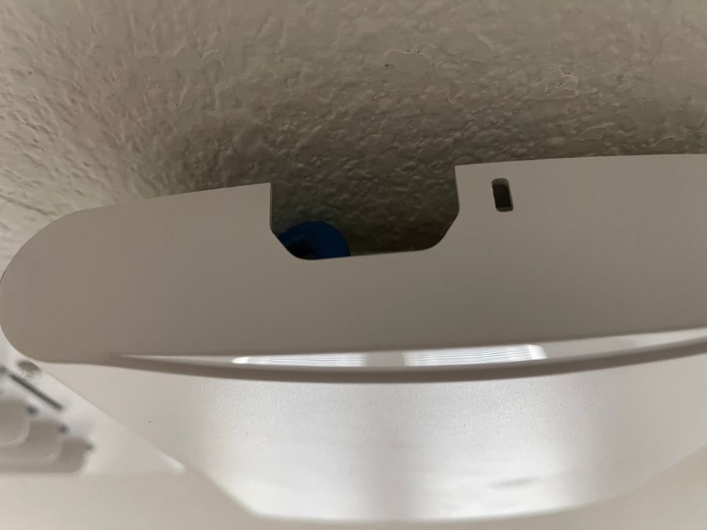

I am technologically savvy and have tried only a few things to try and get everything working. I have pressed and held the reset button on the Ruckus ICX7150-C12P and the Unleashed R510 Access Point. Both of these were done for thirty seconds. I have disconnected the power source for the same duration of time. The lights on the ICX7150-C12P have been the same the entire time; the power light is a steady green and the SYST is a steady amber. I will attach three photographs to illustrate what I see.

As you mentioned and I can see from the picture you shared, there is an amber/orange light on the "SYST" and a green light on the "PWR" on the Switch. Meaning the Switch is stuck in the boot mode.
Basically, due to the power outage/ power spike, the switch went to a state that we call ‘boot mode’ that is not able to boot up properly.

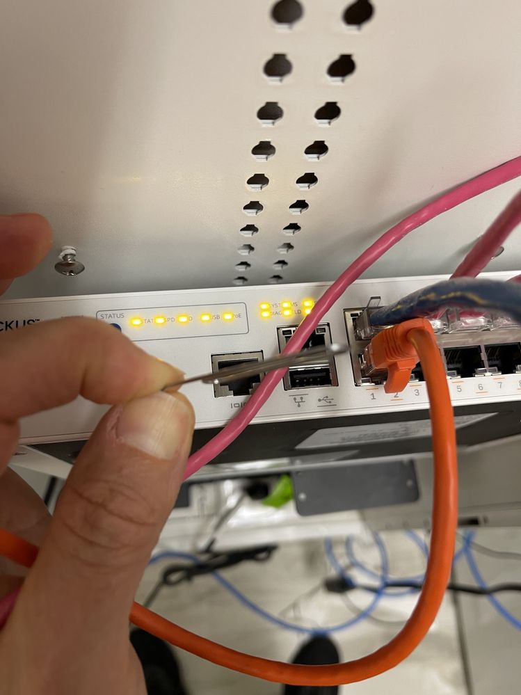

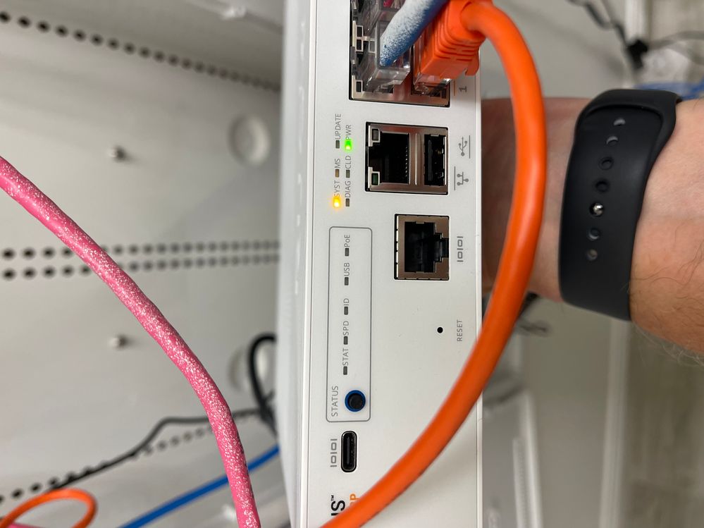

I did multiple attempts to reset by disconnecting the power and push a paperclip in to reset the switch, to no avail. I will attach pictures so you may see I followed the directions exactly as described. I looked at the attached video that you sent me. I want to be very clear i have no technological savviness. I barely know how to do any of this. With that being said, I am not sure how to even get to the first screen that pops up on the video. He is speaking as if I work in this industry. I do not work in this indusRuckus ICX 7150-C12P All Lights.jpgRuckus ICX 7150-C12P Same After All Attempts.jpgtry and do not understand the instructions or how to get to the screen to start doing the work he wishes for me to complete

As described in the previous post I tried countless times to reset it as described. I disconnected the power and pushed the paper clip in the reset and held it until all the light that were amber went out. That did not work.
