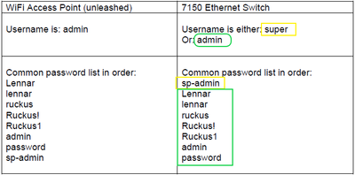

I have done the upgrade to ver 8.0.95r. I cannot login to the switch with any of these passwords in the right column. Am I missing something?
05-21-2025 03:00 PM

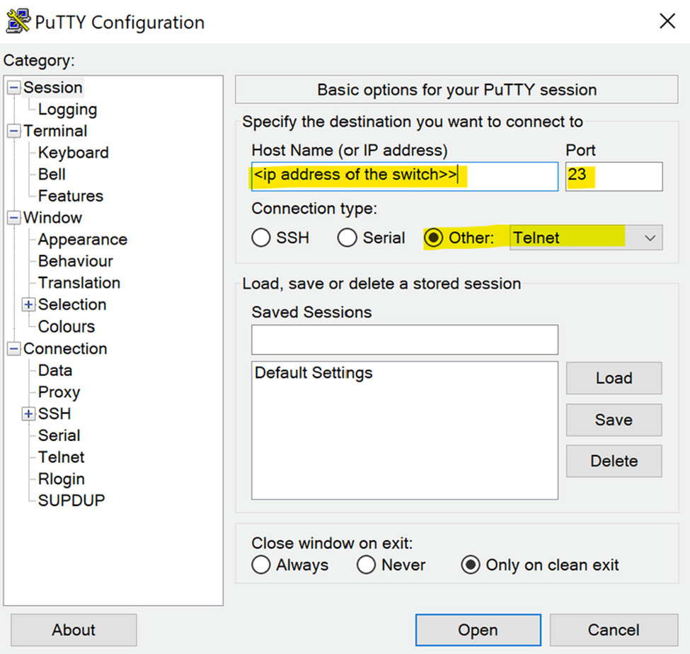

Hello @Hyland6885 ,
I understand that you are unable to access the CLI of the Switch after the Switch upgrade.
Also, you have tried all of the default password combinations; however, it didn’t work.
I would request you to please login to CLI of the Switch using the Telnet option.
We do not need any login credentials to access CLI using the Telnet option.
We do not need any login credentials to access CLI using the Telnet option. If Telnet is enabled on the Switch it can be accessed directly using an IP Address of the Switch.
ICX7150-C12 Router> OR
ICX7150-C12 Switch>
Once you are able to access the CLI, I would request you to please execute the following commands to reset the Switch login credentials.
ICX7150-12P Switch>enable
ICX7150-12P Switch#configure terminal
ICX7150-12P Switch# username super password pass
Where the username is ’super’ and password ‘pass’ (You could choose any of your choices)
To allow the correct authentication please run the following commands:
ICX7150-12P Switch (config)#crypto key generate rsa
ICX7150-12P Switch (config)# aaa authentication login default local
ICX7150-12P Switch (config)# aaa authentication web-server default local
Please share the screenshots if stuck at any step or error (if any) and let me know if you have any queries in this regard.
