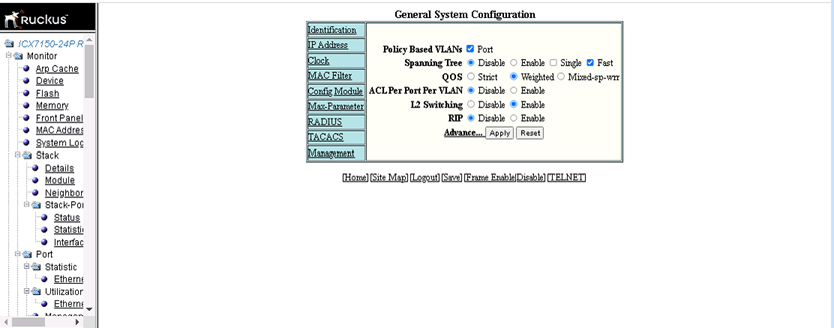

Hi  @kaz
Could you please try to access the Switch IP Address in a web browser?
You should see the Switch Dashboard as shown in the below screenshot to confirm it’s a Switch IP Address. Try to login.
