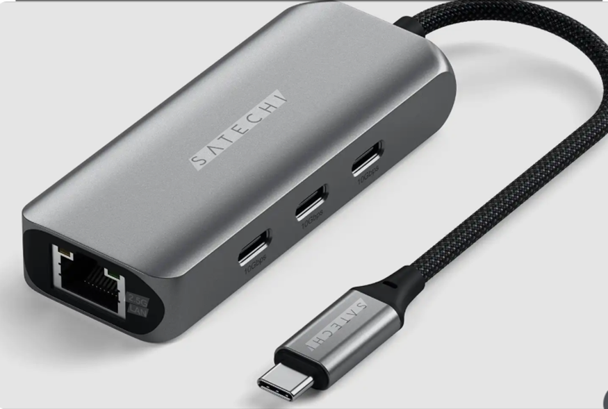

03-30-2026 02:05 PM - edited 03-30-2026 02:06 PM
Hello @charanrajan ,
I understand that your laptop does not have an Ethernet port; however, we can use an external USB-C to Ethernet adapter and connect it to the switch to carry out the software recovery process.
Please use this picture for reference:
Please let us know if you can connect this and able to complete the steps in the Software recovery process.
