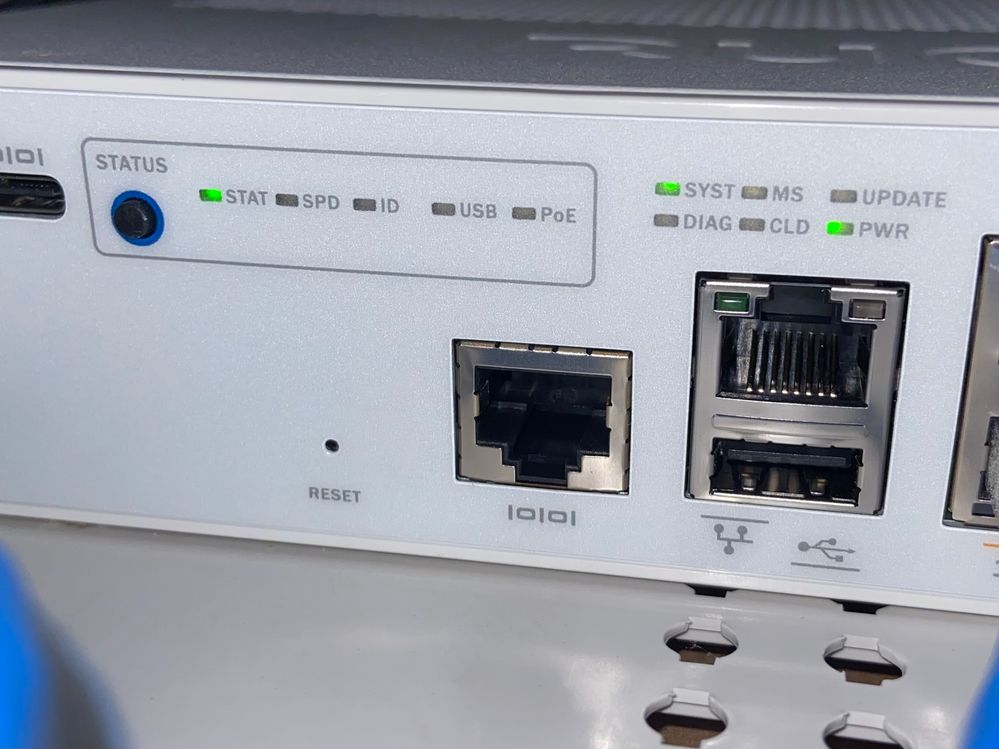

2. On your switch while it's plugged into the outlet, do you see any lights on? (Amber or green) Please let us know which lights are on. (Please refer to the below picture and share a picture of the same, showing the light status and the FULL Switch panel cable connections to the Switch ports)

4. May I know how many Access Points are connected to the Switch? Could you please let me know the light status on the Access Points? Any of these lights are on (Please refer to the below picture and share a picture of the same)
3. My ISP is operational, I can connect to internet and so (am doing so wirelessly) with other devises, (laptop, smart TVs, iPhones, IPad, etc.)
4. I have 2 AP connect to the switch. When powered the ‘PWR’ & ‘CTL’ lights are green. The ‘2.4g’, ‘5g’ & ‘AIR’ lights are Amber.
11-16-2023 09:40 AM
11-16-2023 09:41 AM
I was actually able to figure out adding a photo
