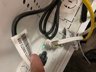

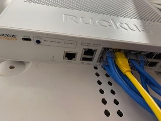

After a power outage last evening my Ruckus unit has NO power throughout the unit. The power to the cord is there and that is were it stops.
Please advise.

Hi @JJT694
Apologies for the inconvenience caused.
Please plug your ICX-7150-C12P Switch into a working power outlet and send us PICTURES and VIDEO of it showing the light status, and cord connected to the Switch and a working power outlet.
Please use the below link to upload a VIDEO and PICTURES:
Hi @JJT694
Thank you for sharing the requested PICTURES and a VIDEO.
