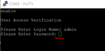

I cannot enter a password, the CLI doesn't show any keystrokes.
Valued Contributor III
Hi @Crossrun21
While entering password texts won't be displayed in the CLI. Once you have entered the password press 'ENTER'.
