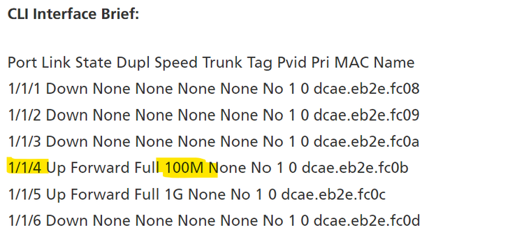

Imran, you are correct. I had a defective cable at the AP in which one wire was broken. I have replaced the broken portion of the cable and my wifi is running perfectly. Thank you for your help!!
