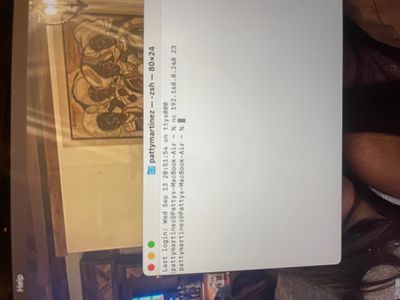

After losing power, my ceiling WAPs stopped receiving power from the POE cable.
The internet is still feeding to the WAP units. I tested this by plugging the POE cable directly into my computer and the Internet works great. I have also tested the WAPs by plugging them in directly to a power source and they come back online and work great.
How do I get my switch unit to start pushing power to the WAP units again via the POE cable?

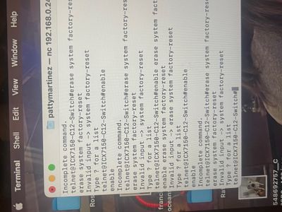

Hi @Patty
Based on the images you have shared it seems like you have upgraded the switch from 8061 to 8080f. As the upgrade must be done twice from 08061 to 08080f then from 08080f to 08095 UFI, please continue to upgrade the switch to the code 8095 UFI by following the step '20' using the below link.

it no longer allows me to enter the switch via terminal
