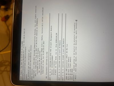

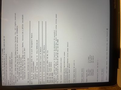

After losing power, my ceiling WAPs stopped receiving power from the POE cable.
The internet is still feeding to the WAP units. I tested this by plugging the POE cable directly into my computer and the Internet works great. I have also tested the WAPs by plugging them in directly to a power source and they come back online and work great.
How do I get my switch unit to start pushing power to the WAP units again via the POE cable?

The picture you shared is not clear. Could you please once again share a Clear picture of the commands output to assist you further?

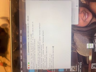

At this point, we should factory reset the RUCKUS ICX-7150-C12P Switch once again by the below process.
Please note, that there will NOT be any loss of data or configuration. Factory reset will just reset with the default configuration.
Please perform the below commands to factory reset the RUCKUS ICX-7150-C12P Switch. (Also please refer to the below screenshot)
erase system factory-default
y
Once the factory reset is complete, the RUCKUS ICX-7150-C12P Switch will discover the Access Points connected to it and it gets connected to the Unlashed system.
