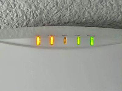

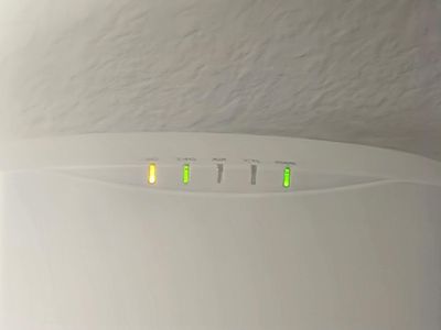

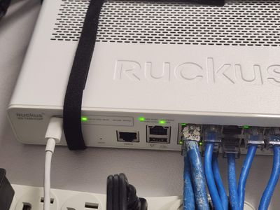

I can connect to internet when I am connected to AT&T but when I switch it with the Spectrum Modem, I don’t seem to have internet connection. I have verified that Spectrum service is working by connecting directly to the Modem without the switch. Power cycling both the modem and the switch does not seem to help. I even did a factory reset of the switch by referring the instructions on this forum but that does not seem to change anything. Below are the status lights on the switch and the 2 APs we have connected.

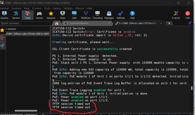

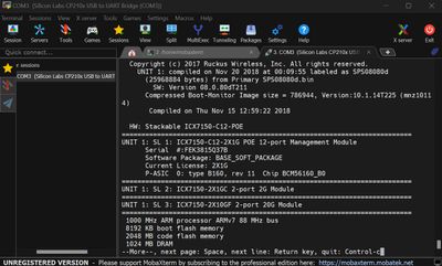

I tried to access the switch using the web browser but the passwords shared on this forum did not work. So I consoled into the switch. Below are screenshots of the status I see. Is the TFTP timeout okay. I am lost on what the issue is. How can I debug this further and resolve this. Your help is much appreciated.

I missed mentioning but I can confirm the incoming ethernet connection is connected to the one of the 12 ports. I did not touch the connections on the switch side only swapped the att and spectrum modems on the other end.
