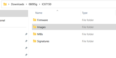

working on moving the folder i created and renaming it "Upgrade," but also, see below, i do not have a "Boot" folder. is that a problem?

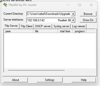

okay i did everything exactly as it said and it still says empty file name. here is a screenshot of my tftp application configuration:

We do not require a boot file for UFI images. 8095 version is a UFI image.
Just make a folder of Upgrade with a single file (SPS08095gufi.bin) as shown in the below screenshot. And Follow the Steps 5 and 6.
As you mentioned “okay I did everything exactly as it said and it still says empty file name. here is a screenshot of my tftp application configuration:
Once you browse and select the folder, you can click on ‘Show Dir’ here you will find your file. Just copy and paste in tftp configuration of Switch Web GUI. (Please refer to the below screenshots)

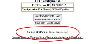

okay i did EXACTLY as you said, and i get the same STATUS message when i click copy from server to flash:
