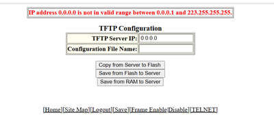

i'm not sure why it won't let me copy my snippets sometimes and other times it will, but i am on step 7 of option 3, TFTP configuration. In the instructions and provided images, the server IP and file name show up on the TFTP config box. on mine they show 0.0.0.0 and blank. when i click copy from server to flash and save, i get an error message. what shall i do from here?

Could you please share the screenshot of where it is showing 0.0.0.0 and please share the screenshots of the error that you are getting?

Hi @relingburg
Please enter the IP Address of the configured tftp Server at the place of 0.0.0.0 and try again with the Upgrade process.

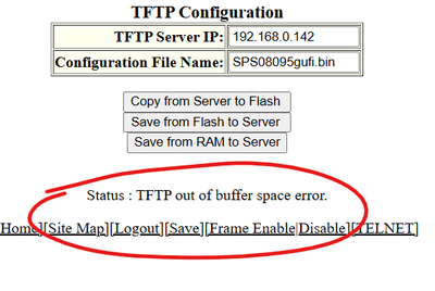

so i am supposed to type in the IP address and the file name manually and THEN hit copy from server to flash? if so, i just did that and this is what happened:
