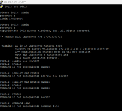

HI @relingburg
Could you please send me a screenshot where it is stuck?

12-06-2022 11:33 AM
Hi @relingburg !
You are log in in the Access Point CLI you need to log in in the ICX-Switch CLI.
Try to reboot your router to see if you can find the IP address of the switch.
If the access via IP address is not possible here is a guide how to access to the Switch via console (cable access between your PC to the ICX 7150-C12P) in this case we need a USB type C to USB standard or Console cable Rj45 to USB.
