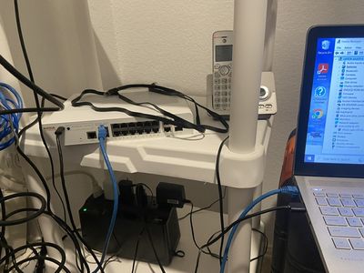

Internet working, RUCKUS Switch ICX7150 does not turn on. Ruckus support team is giving me the run around asking for pictures (already posted). I’m a Lennar Home customer and promised lifetime warranty for RUCKUS. It’s been 30 days and I have not received the RMA so I can replace this non working switch. RUCKUS need to honor the commitment of lifetime warranty. Send the RMA. Perhaps complaints should be filed at the Bettef Business Bureau.

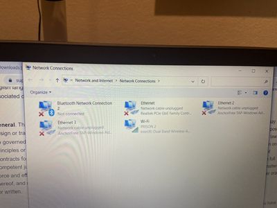

The Ethernet cable connection does not work on the switch. When plugged in the network adapter still reads unplugged. See picture Row1 Col2. Therefore I cannot configure the IP using the Ethernet connection on the ruckus switch. The Ethernet connection on the laptop reads plugged in when connected to other devices but not the ruckus switch.

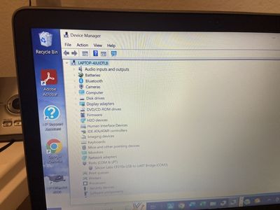

Hi @Mars55
Please connect software recovery cables to the Switch and the laptop and help us with a screenshot of the Device Manager showing the COM ports. (Please refer to the below screenshot)
06-15-2023 01:36 PM
Here’s the screenshot. Only reading the USB C connection. How many more attempts before the RMA is issued? I’m getting very frustrated and unhappy with this process.
