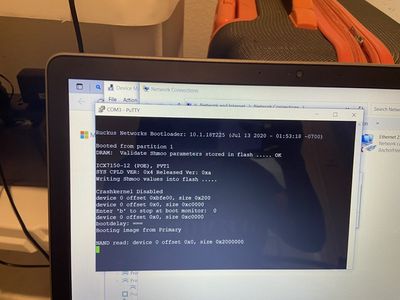

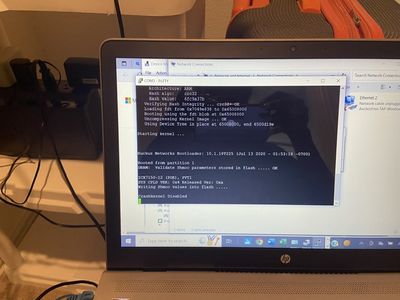

Hi @Mars55
Could you please share a screenshot of the Putty screen with the error you are getting?
Here is the putty screen
Hi @Mars55
Thank you for the response and for sharing the requested information.
As per the error we are getting on putty seems like the Kernel image is corrupt and Switch is flashing lights continuously. And Switch is not powering up normally when plugged into a well-known power outlet.
Based on the troubleshooting done, you confirmed, and we saw that after the reset, booting up the Switch, and trying the software recovery process multiple times, the failure persists. This Switch unit Should be RMA (Return Merchandise Authorization) in simple words replacing it.
Thank you again for your understanding and we appreciate your patience.
