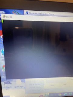

As per the error we are getting on putty seems like the Kernel image is corrupt and Switch is flashing lights continuously. And Switch is not powering up normally when plugged into a well-known power outlet.
Based on the troubleshooting done, you confirmed, and we saw that after the reset, booting up the Switch, and trying the software recovery process multiple times, the failure persists. This Switch unit Should be RMA (Return Merchandise Authorization) in simple words replacing it.

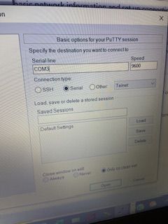

On the 4th console reset attempt using a paper clip, the switch appeared to reboot, then several amber lights appeared on the switch flashing quickly nonstop with lots of static clicking sounds then the switch powered off. This resolution has not worked.
Hi @Mars55
Please share the screenshots if stuck at any step or error (if any) and let me know if you have any queries in this regard.
I’ve performed all the steps. Downloaded firmware, downloaded putty app, when I select the port to open putty the “boot” drive does not appear. I’ve included photos. I cannot reload the software.
