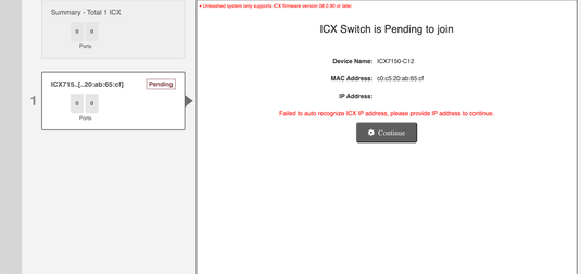

12-06-2022 02:49 AM
This is what I get when trying to find out the IP for my switch, I have tried to run an IP scanner, and nothing. I need the IP to continue in the process.
The definition of damaged includes not working or flawed and that accurately describes what is going on with this switch. I just need it to work. If I can get on the phone with someone that'd be great too. I would like to have this fixed as soon as possible.
12-06-2022 04:08 AM - edited 12-06-2022 04:08 AM
HI @opor6798
Hope you are doing well !
Please reboot your local router once is back please run the scanner.
If via IP address is not possible I will leave you a guide how to do it using the console cable.
