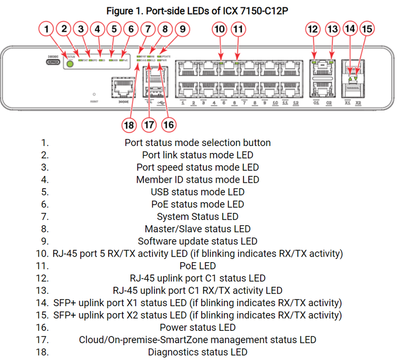

1:Check the type of new router you have now? Please share the model, so we can confirm, in here, ensure that between the ISP router and the ICX7150 Switch there is a connection in one of the 12 or 8 Ethernet ports.
Note: the ones mark in yellow are the available Ethernet ports to connect all your devices, including the connection between your ISP router and the ICX7150 Switch.

If I plug the router directly into one of the "Yellow" ports, the lights on both of my R510's turn to yellow for the 2.4 and 5G. If I plug my router into the 13th port (Out-of-band management port) the 2.4G turns green on the R510's and the 5G continues to stay yellow.
11-14-2022 10:58 AM
1:The router must be connected to one of the yellow ports, the 13th port (Out-of-band management port) is for management, so leave the connection in one of the yellow ports.
