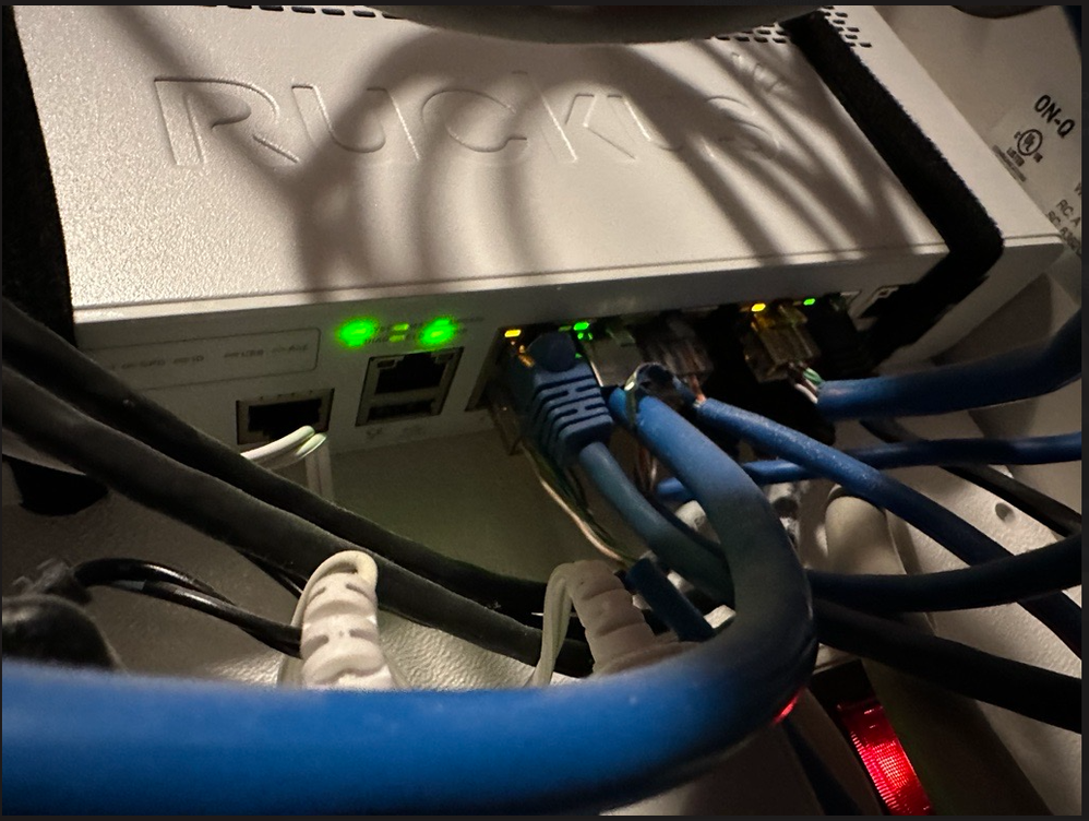

Every couple days the RUCKUS device loses power, but if I unplug and plug back in, lights return and everything is on/back to normal. It happened this morning when I woke up and just happened for the first time during the day while using the internet, so it is becoming more frequent.
Started maybe a week or two ago, possibly after a power outage.

10-19-2023 11:40 AM
I found the IP by connecting to my ISP Gateway.
192.168.1.103 / ICX7150-C12-Switch
But I can't connect to it using PuTTY or MobaXterm
all username/password combinations do not work
