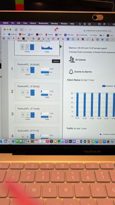

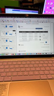

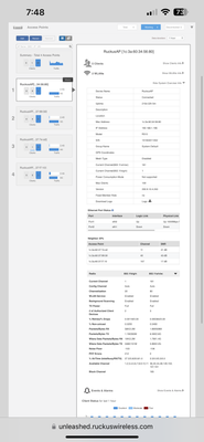

Please log in to your Unleashed system on a LAPTOP WEB BROWSER using the Master AP IP Address OR https://unleashed.ruckuswireless.com/ ? Please check the current version of your Unleashed Access Points and share a screenshot of the same.

Could you please share a screenshot showing the Unleashed Access Points version? (Please refer to the screenshot in my last post for reference)
