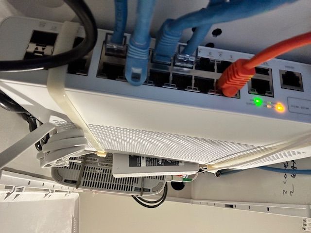

we had power outage in the morning, post that I am not Gettig any power in the Ruckus box
I tried unplugging the power, not change . any solution greatly appreciated

When your switch is connected to the outlet, do you observe any illuminated lights (amber or green)? Kindly describe which lights are visible. Additionally, please provide a photo showing the status of the lights and the full switch panel with cable connections to the switch ports.

HI Imran
Attached the photoi can see two light , one orange and greeni can see two light , one orange and greenthere is no light or signal on thisthere is no light or signal on this
Hi @Panirajh04
Thank you for your response and for providing the information.
Based on your description, the Orange/Amber SYST LED on your RUCKUS ICX-7150-C12P switch indicates that the device is stuck in boot mode.
To resolve this issue, please refer to the following RUCKUS Lennar Support Knowledge Base article, which provides step-by-step instructions:
https://community.ruckuswireless.com/t5/RUCKUS-Lennar-Support-Knowledge/Fixing-RUCKUS-Switch-with-an...
If you need any assistance while following the guide, feel free to reach out. I’ll be happy to help.
