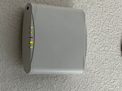

When the system is working it looks like this:
One access point shows four lights illuminated solid green (Power, CTL, 2.5G, 5G)
The other access point shows three lights illuminated (Power, 2.5G, 5G) with the CTL light not illuminated at all.

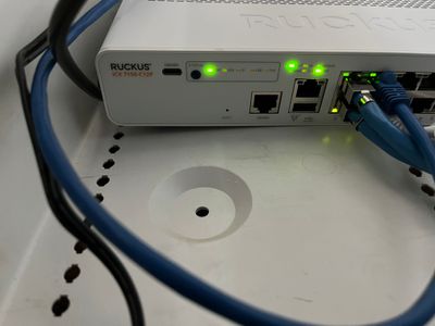

The switch has the STAT light illuminated green within the outline on the far left. And the SYST and Power lights are illuminated green in the array of 6 lights with no outline. The ports are blinking green randomly.
The system stays on like this for a random amount of time, sometimes 10 minutes, and sometimes 3 hours, but eventually it begins displaying different light patterns on the switch. At that point the system starts to look like this:
[Same status] One access point shows four lights illuminated solid green (Power, CTL, 2.5G, 5G)
[Same status] The other access point shows three lights illuminated (Power, 2.5G, 5G) with the CTL light not illuminated at all.
[New status] The switch has the SPD light illuminated green within the outline on the far left. The SYST light is flashing amber. The Power light is illuminated green. The ports are blinking green randomly.
This carries on until it all turns off. At that point the system looks like this:
[New status] One access point shows no lights
[New status] The other access point shows no lights
[New status] The SYST light is steady illuminated amber. The Power light is illuminated green. The ports are all off.
AP
AP 1 CTL
SwitchThen it reboots back to the first statuses I listed above when the system is "working" and the WiFi functions for another random amount of time until the cycle starts again.

Please share the image of the switch and the access points showing the LED status and the cable connections.
07-20-2023 06:50 AM
I have uploaded in my original post, please check.

Hi @saurabhk01
To assist you further please upload the image of the switch and the access points showing the LED status and the cable connections to the switch ports.
07-20-2023 07:48 AM
Please find photo.

Hi @saurabhk01
Please share the image / pic of the status of the switch in the unleashed app.
Also for further troubleshoot please share the output of the below commands by following the steps.
By IP address: To fix this issue, we must identify the ‘current’ IP address assigned by your local router to the switch ICX-7150-C12P
ICX7150-C12 Router>
Show version
Show flash
Also please check whether the cable connected to the devices are in good condition.
