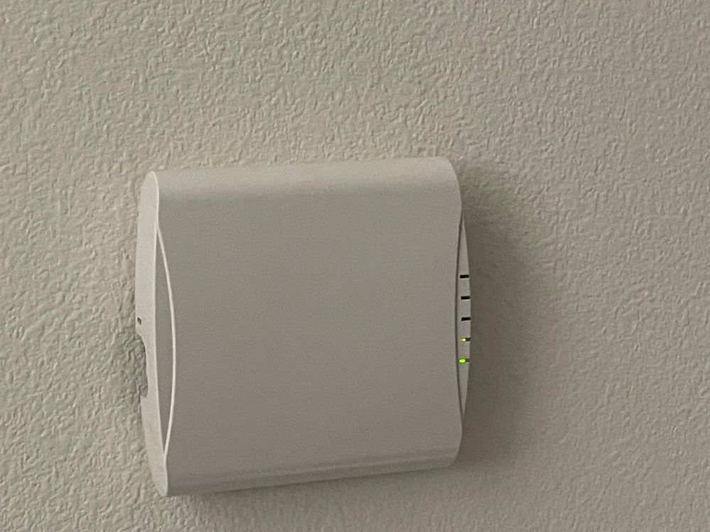

4. May I know how many Access Points are connected to the Switch? Could you please let me know the light status on the Access Points? Any of these lights are on (Please refer to the below picture and share a picture of the same)

For next steps, I'm planning on proceeding with the software recovery process, Right now 1, 7, and 16 are green on the router. Each of my three access points has a blinking green light for 5g, and a solid green light for 2.4G. Any tips or advice before following those instructions would be greatly appreciated.

To assist you further, as mentioned in the previous post, please share the pictures of the Switch showing light status with cables connections and Access Points with light status.

07-20-2023 01:31 PM
Apologies - the photos did not make it through. Re-posting here.
Switch
All three access points look the same
