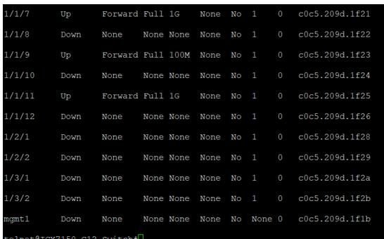

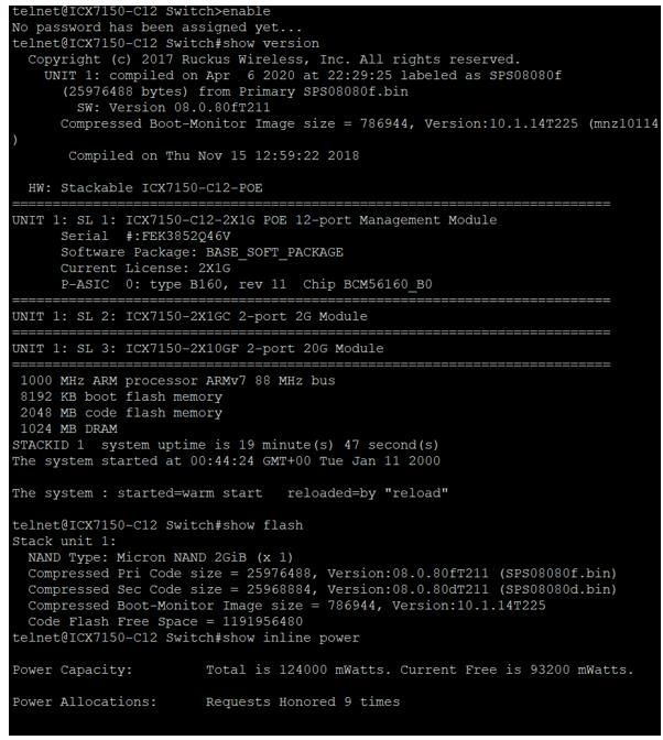

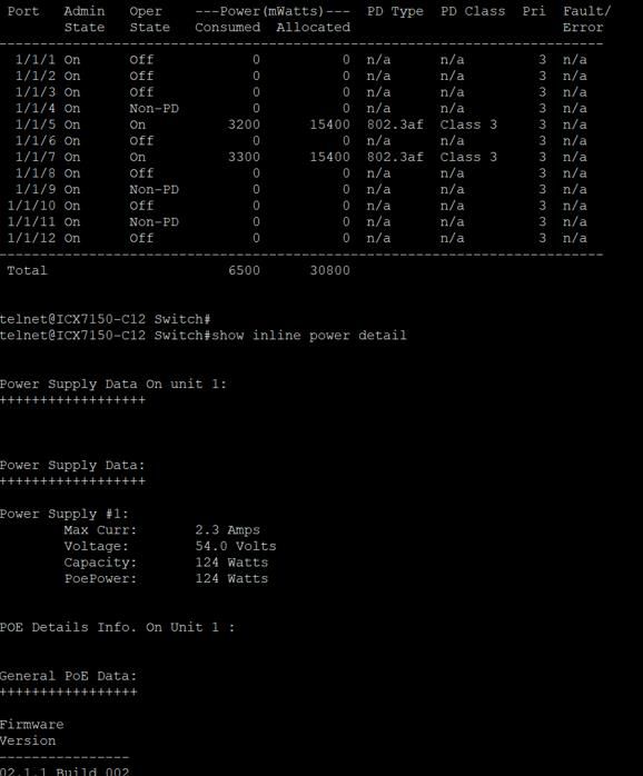

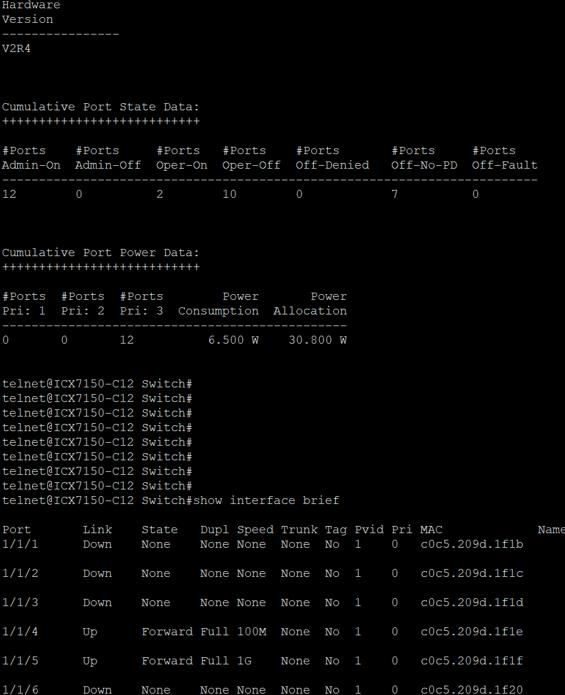

I just tried flashing the new UFI to the Switch and I made it all the way to step H3 where I had to "write memory" but I received an error message that stated "There is no startup config file, unable to save legacy config". I then tried the next step to boot system flash primary and the connection was broken so I am not sure if it worked. See pictures for the code after I input the commands above. At this point, what would be my next step? Do I try re-flashing the UFI? Also - what wifi should my PC be connected to? Should it be on a wifi other than that of my Ruckus/WAP?
