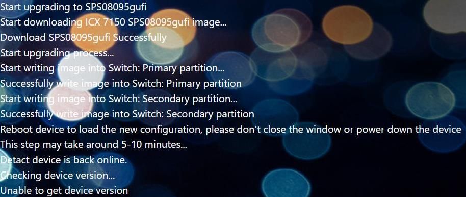

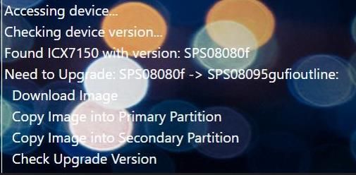

I was able to finally reset admin password, and I tried flashing the UFI via the tool, however it appears something happened. See attached images. Now my WAP's are not showing up at all and I cannot access internet via the Switch.
