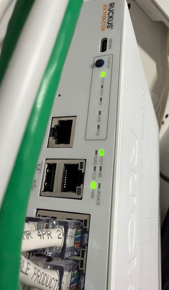

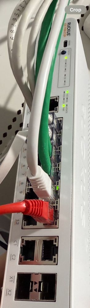

1. Please provide a photo showing the status of the lights and the full switch panel with cable connections to the switch ports.

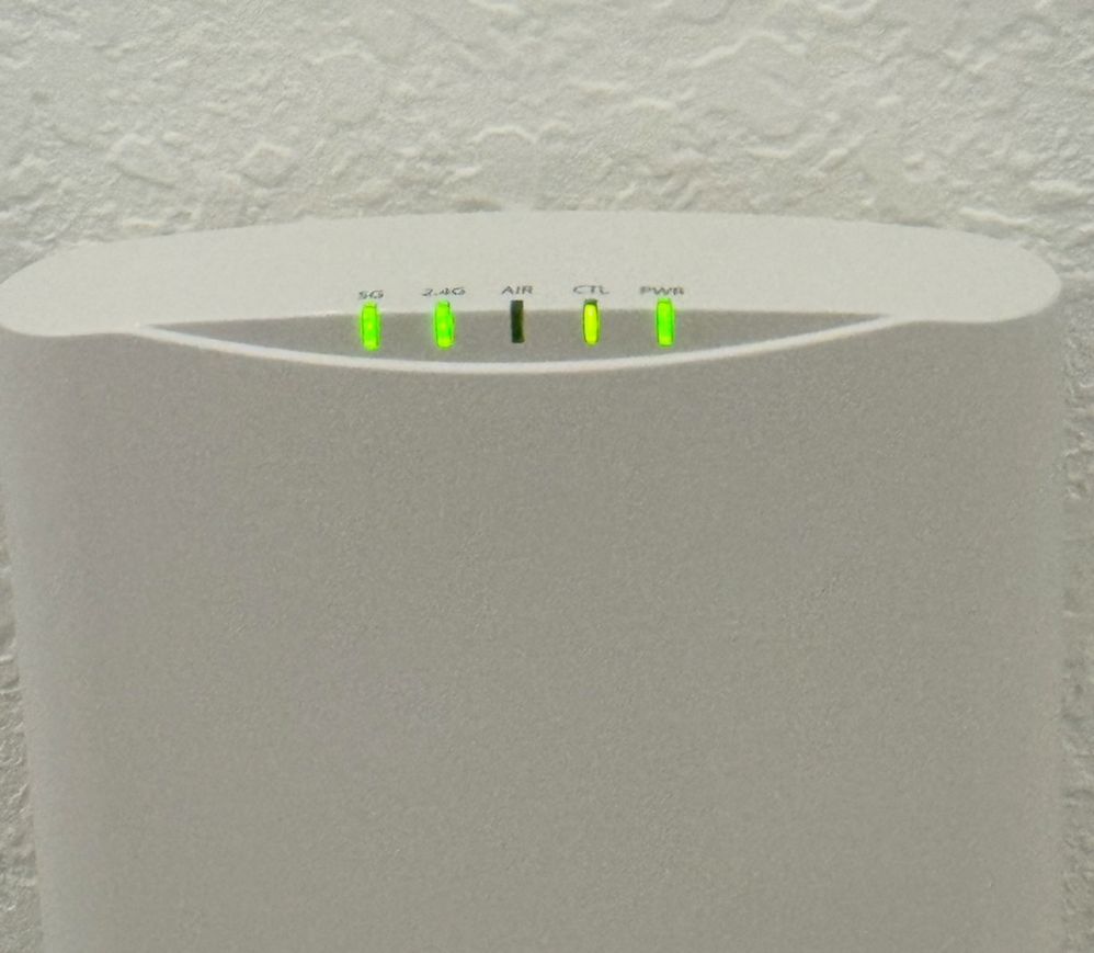

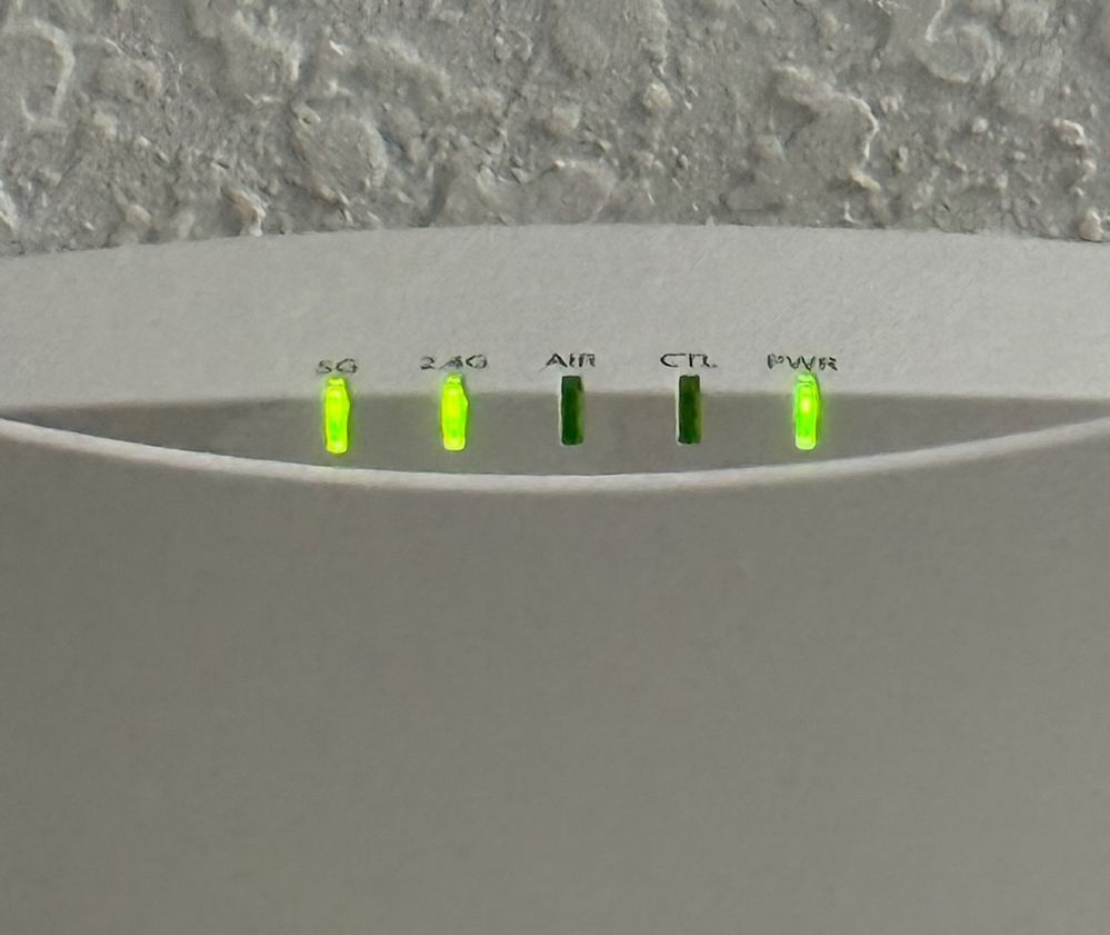

3. How many access points are currently connected to the switch? Please describe the status of the lights on the access points. Similarly, include a photo showing the access points' light status.
Please help me with the above queries and should you have any further questions or concerns, feel free to reach out.
10-13-2025 05:55 PM
I am attaching all photos per your request. My ISP is stable and functioning. I have 2 access points.

Thank you for your recent correspondence and information.
As per the pictures that you shared, the lights' status and cable connections of the devices are in a normal state.
