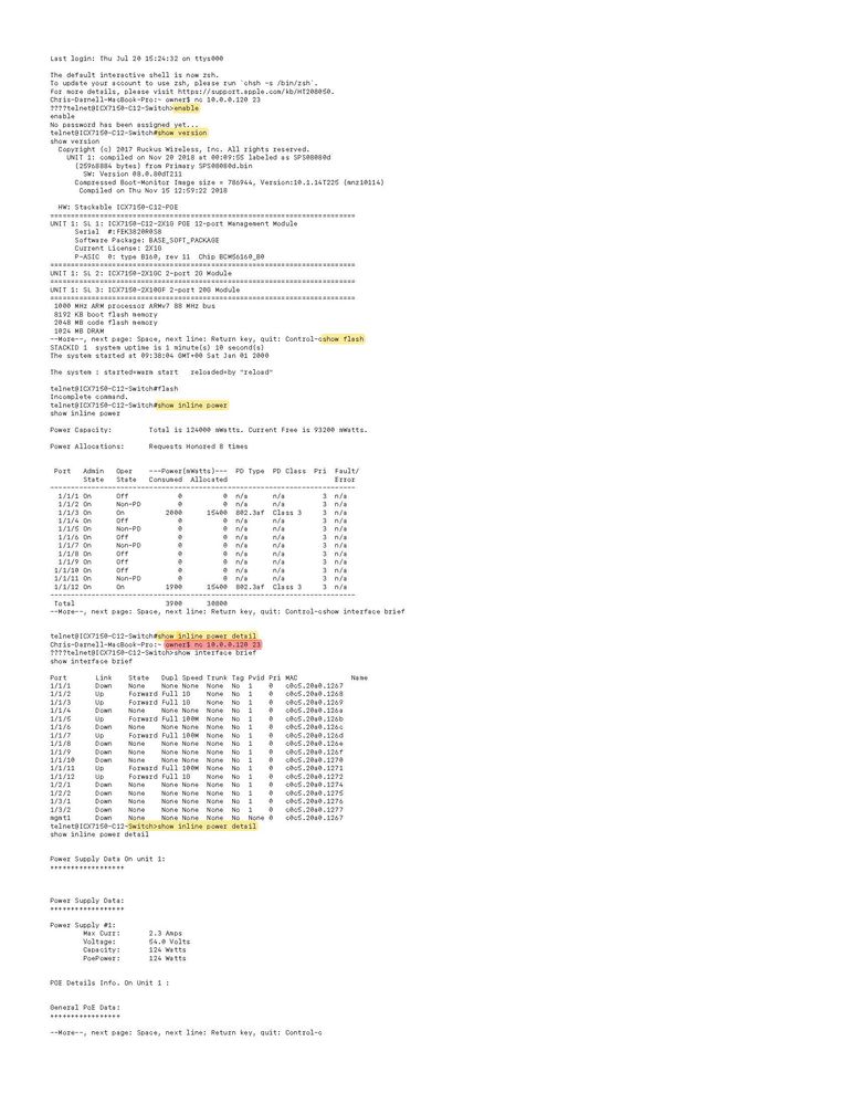

07-20-2023 02:55 PM
Okay. I had to switch the my Macbook and use Terminal to get the responses. See below.
While doing that, the Port Link Status light went off, the System Status light went to blinking amber then solid amber, the back to green and the Port Link went back to green. This took a few minutes to cycle through. You can see the pause in the response at the red highlight.
07-20-2023 03:18 PM
Hi @cwdarnell
Thank you for the response and the confirmation.
We suggest upgrading your switch to the latest stable version as your Switch is on an older version that is 08080d. (as highlighted in the below screenshot)
