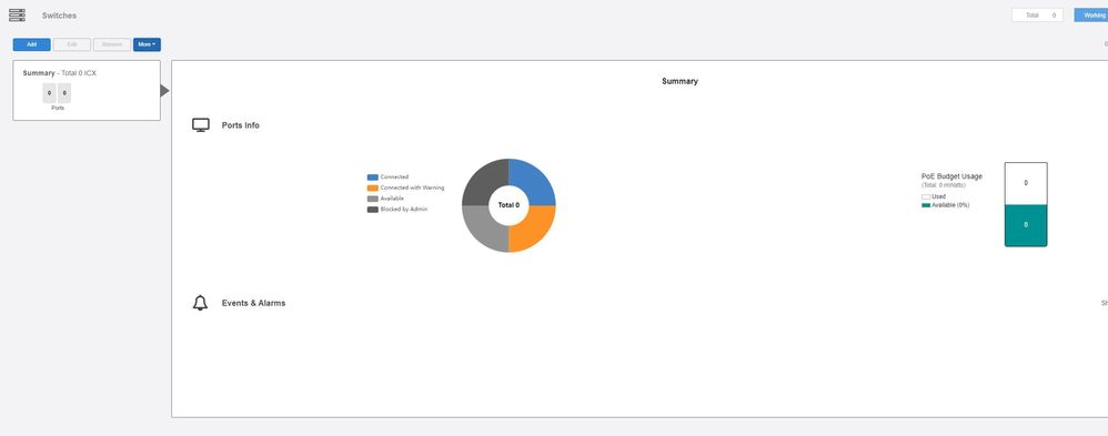

07-20-2023 12:21 PM
My system does not show a switch:

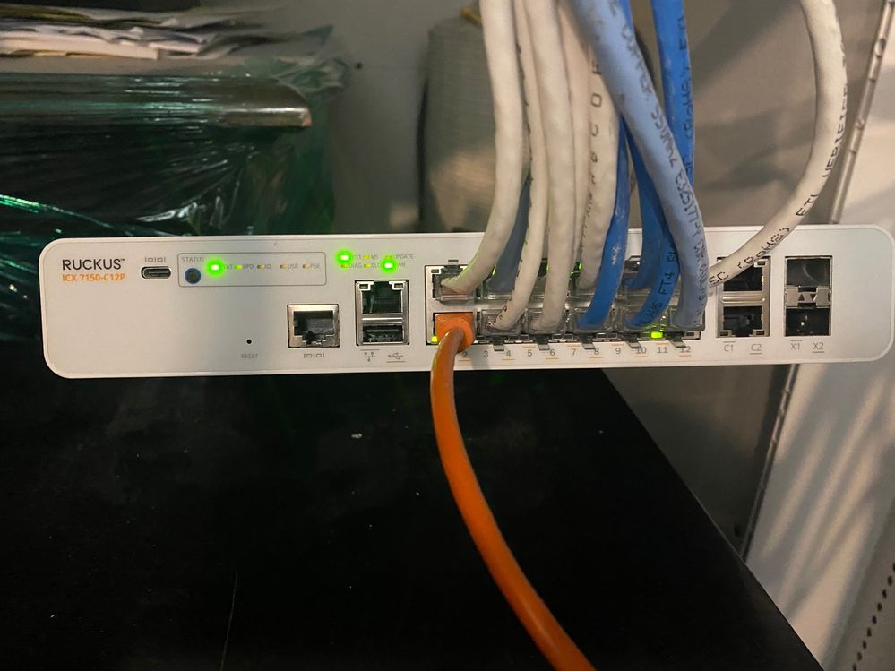

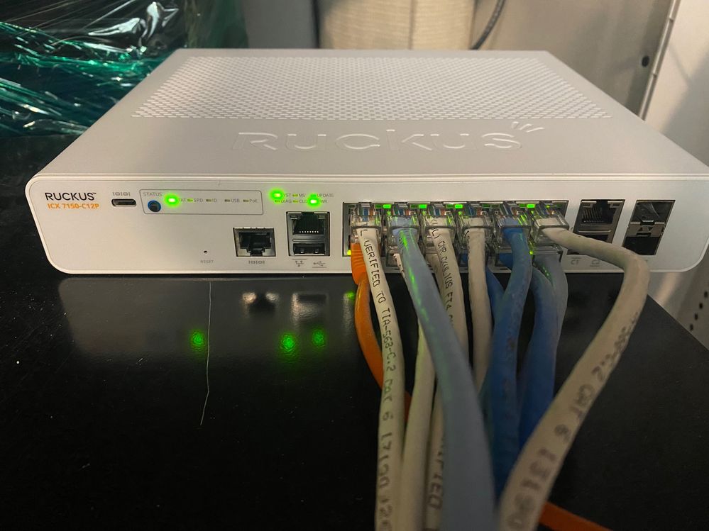

07-20-2023 12:27 PM
Hi @cwdarnell
On your switch while it's plugged into the outlet, do you see any lights on? (Amber or green) Please let us know which lights are on. (Please refer to the below picture and share a picture of the same, showing the light status and the FULL Switch panel cable connections to the Switch ports)
Please share the above requested picture and let me know if you have any queries in this regard.
07-20-2023 12:42 PM
The lights on the left side that are on are the Port Link Status, System Status and Power.
The lights on the right side are the two APs, masterbed room, living room, bed rooom 3 and the orange cable from the modem. All lights are green.
