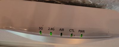

4. May I know how many Access Points are connected to the Switch? Could you please let me know the light status on the Access Points? Any of these lights are on (Please refer to the below picture and share a picture of the same)

Been working fine for 3 years and just started randomly resetting for the last few days.  No power outage that we know of.  All connections are strong.  Called and verified with spectrum and they reset and checked the signal which was good.  For the photo all lights are on but then it resets and power turns red as it turns back on. Takes like 5 to 7 minutes to fully start back up.   This happens every 15 to 30 minutes.
โ€ƒ
โ€ƒ
Hi @Danielledyar
As per the light status of the Access Points, they seem normal.
