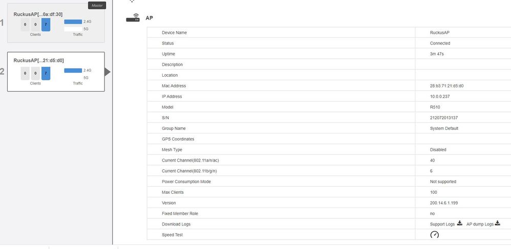

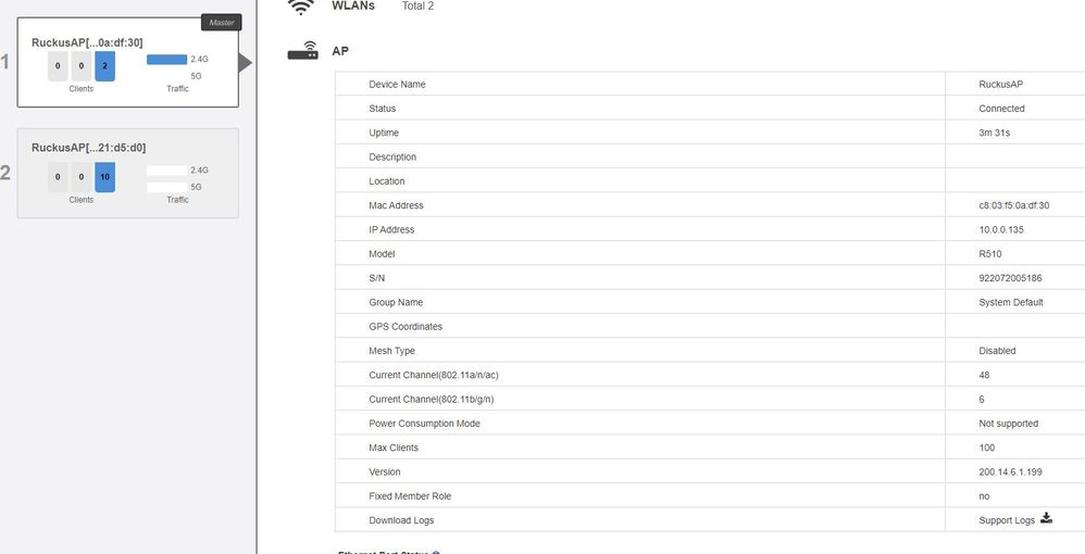

Yes.  Both upgraded to 200.14.6.1.199 and yes, they are still rebooting.
