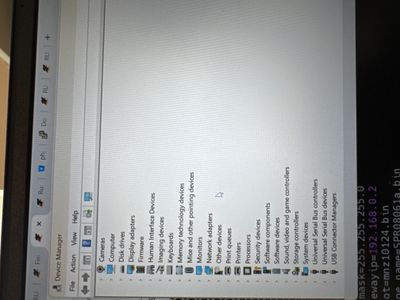

I tried physical reset but the status flash continued indefinitely. I am trying option 2. I am finding the port in the device manager but I cannot locate it. Please help.

Hi @alpogi2dmax
1. Please make sure to download the zip drive for the file below & "extract all". Once it's extracted, run the file, the driver should be installed using the 2 links below.
Link 1: https://support.ruckuswireless.com/software/1414-brocade-ruckus-7150-usb-serial-driver-windows
Link 2: silabs.com/developers/usb-to-uart-bridge-vcp-drivers?tab=downloads
Once installed restart your laptop and try to locate the COM port details under 'Ports (COM & LTP)' with cables connected between the Laptop and the Switch (Refer to the below screenshot), Please check and let me know if that works.

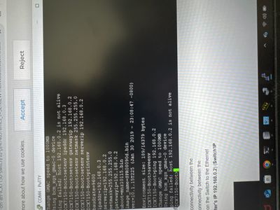

12-06-2024 02:22 PM
I was able to install the drivers. I have run Putty. When I am trying to ping for connectivity, it shows that is is not alive. What do I do next?
